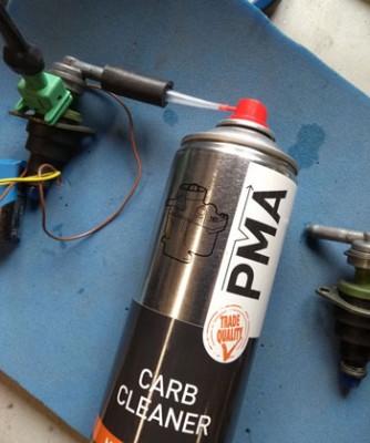

I metered them out to check coil resistance which was ok, then connected a 9v battery. You can hear a slight click when voltage is applied to an injector, the left hand one was not making any noise. There is a lot of stuff on the web about cleaning petrol injectors which I followed and I managed to unstick the injector by liberal amounts of carb cleaner. However, rather than put it back in I decided to send them both off for full servicing. They've been in the donor bike engine for 24 years and although it hadn't done a huge mileage I think time is more the enemy of bikes than usage.

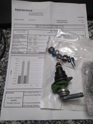

One of the rubber seals had a chunk out as well so I sent them to Injectortune who stripped them, cleaned them ultrasonically, fitted new seals, micro filters etc all for the sum of £34 including return postage. It certainly runs better but really needs lots of good long trips to blow the cobwebs out. Anyway, that's the engine taken care of for now...

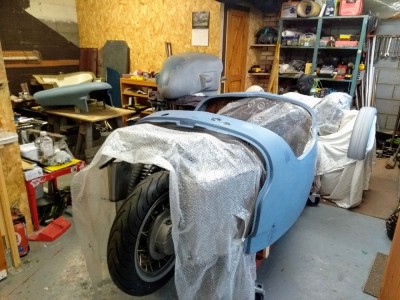

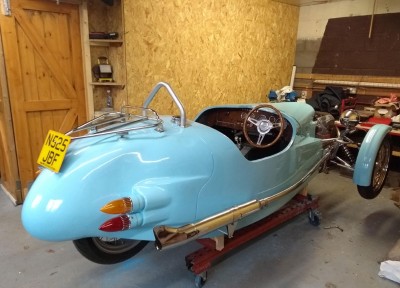

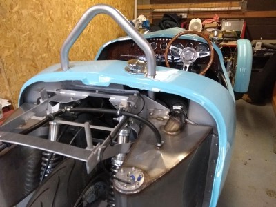

With the body glued on and the current warm temperatures I've started the process of painting the Triking in my home workshop. As with my previous Triking I'm going to paint it by hand, or more accurately, apply the paint with a small foam roller and then use a high quality paint brush to "tip off". The roller applies the paint evenly and the brush smooths the paint so that a high quality finish can be achieved. I'm using International Paint primer, undercoat and top coat which is primarily formulated for boats, especially fibreglass so I should get a good result.
You may wonder why I would spend so much money on the mechanical build and then not have it sprayed. There are several reasons; I want the Triking to be usable and not have to worry about an expensive paint job being damaged when it's parked up, it'll get chipped etc during normal usage and I can touch any damage up myself and painting it this way means I can do it at home, without special masks etc or covering the rest of the workshop in excess spray paint - and of course it's a lot cheaper!
Anyway, I'm now at the stage of applying primer and undercoat very carefully and then sanding most of it back off again, patience is needed for this stage! I've attached a photo showing how the workshop looks at the moment, the body has had primer and two coats of undercoat as has the bonnet, the tail is on primer/undercoat and I've just primed the mudguards. When it's time to top coat I'll clean the garage and dust sheet the bench, wet down the floor etc to minimise dust. It probably won't look as good as a top quality spray but I'll be happy if it turns out like my previous Triking....
Joined: Thu Sep 27, 2018 4:52 pm
Post by peakrock » Sat Sep 19, 2020 5:51 pm

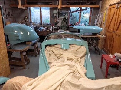

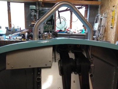

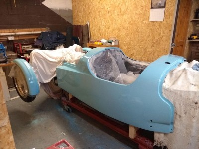

Final top coat today which makes 2 coats of primer, 1 coat undercoat and 3 top coats - all rubbed down and applied by hand. Low tech but I'm fairly happy with the result, like anything you do yourself you tend to focus on the bits that are not quite 100% rather than looking at it overall. Fluorescent light is also very good at showing any orange peel, micro runs, specks of dust etc but fortunately sunlight tends to be more forgiving. A couple of shots of what it looks like at the mo, I'll let the paint harden up for a while then I'll put it all together ready for the MSVA, though when that will be who knows....
