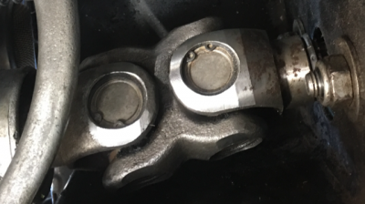

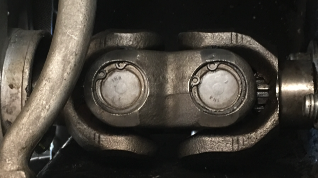

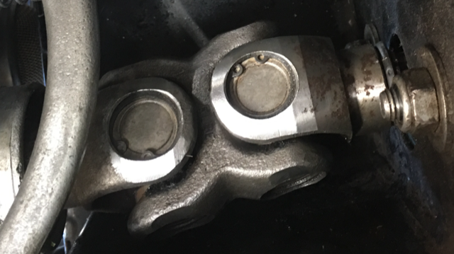

After removing and replacing the front driveshaft and bearing I didn’t notice I’d not fitted it exactly in the place it was originally. Driving the car I notice I had far more rumble at low speed from the front UJ area. I jacked the car and noticed the UJ was slightly out of line. I loosened the bolts off and slackened the bearing collar allen screws and levered the bearing back into the original position. Another drive down the road and noise gone. The pictures show before and after adjustment. It’s well worth checking the alignment if you are experiencing similar annoying noises.
Re: Triking Propshaft
Thanks. Good tip to pass on. You would think that as there is a UJ alignment would not be quite so critical. However in the area of the car which amplifies all sounds and vibration I agree and have found the straightest running is defiantly best.
