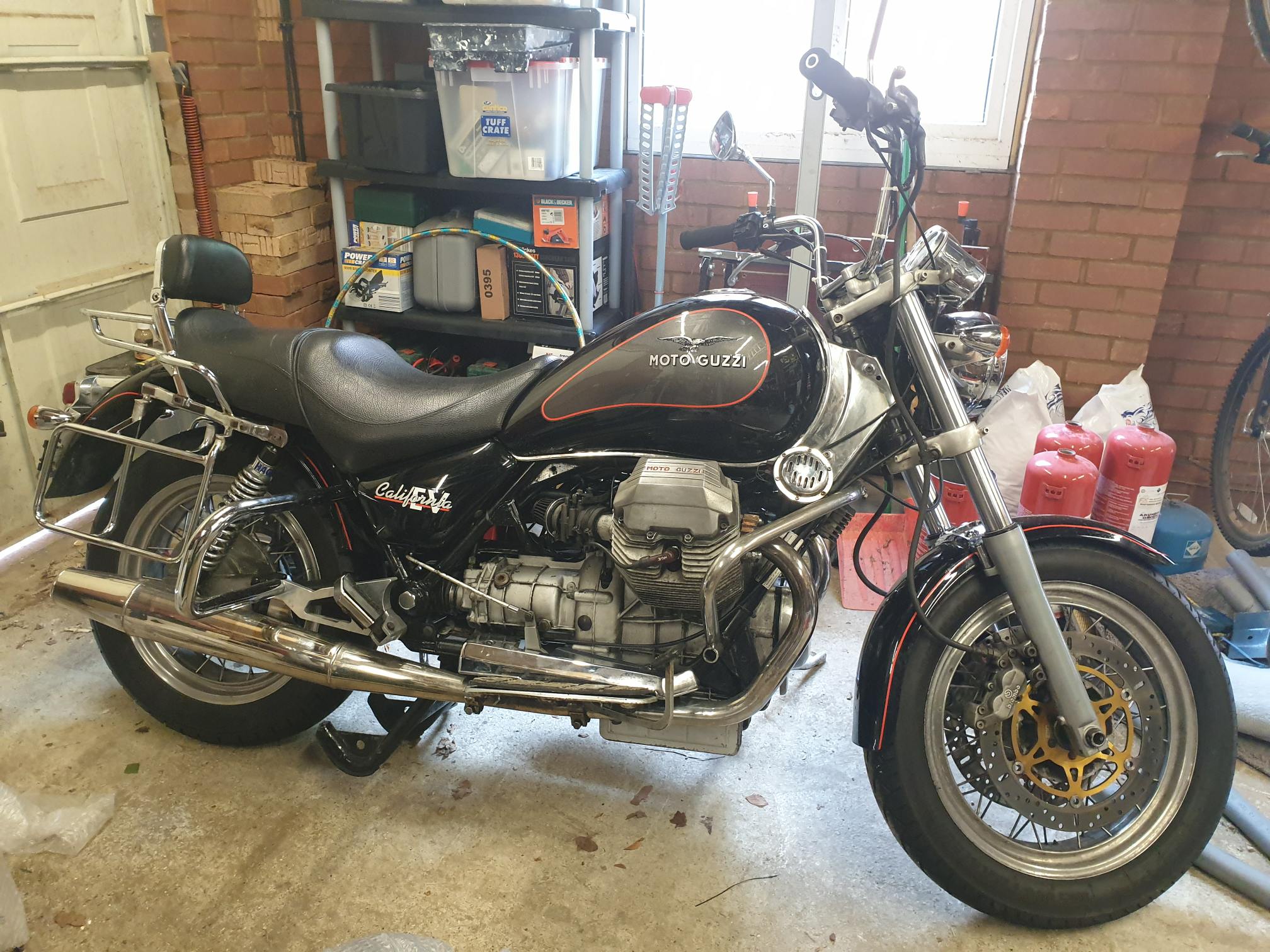

Well the choice between type 3 and type 4 has been made by the installation of a California in my garage :). I feel a bit bad for breaking such an impressive machine, but justify it by probably saving a bikers life!

Good luck, let’s see a picture of the bike so we can see what you will be sacrificing!

Unfortunately riding the donor isn't an option for me as I'm not licensed for such a big 2 wheeler. Kind of pleased about that as it's a beast and certainly not for a novice! Although I can't ride the bike, it seems to make the right noises and none of the wrong ones, exhausts are the right colour etc. I think the only real attention the engine needs is a good clean and respray, but that probably needs a thread of its own when the time comes.
