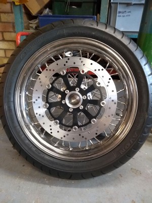

Post by peakrock » Tue Jul 07, 2020 10:18 am
Whilst we're on the subject of brakes I couldn't resist posting a picture of the front wheel with disc attached...some serious brakes with this combination...

Post by Donaldo » Tue Jul 07, 2020 10:48 am
Thanks for the detail on brakes.
That disc is awesome

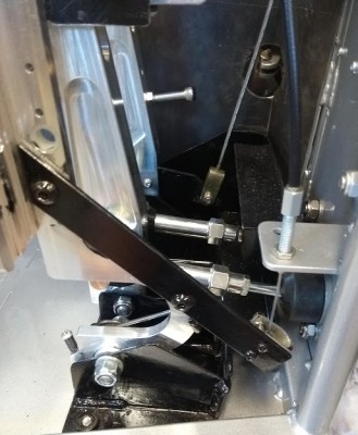

I like the Type 4 pedals. Are they pretty straight forward installation? I was thinking about them as the standard supplied gas pedal had to much lateral slop for my liking. I have a LHD Triking so I should have a little more room to install them.
Ivan
Posts: 254
Post by peakrock » Sun Jul 12, 2020 11:11 am
The Type 4 pedal box is wider than the Type 3 Triking fabricated one and a signicant amount of modification was necessary to get it to work in my Type 3:
I had to cut a small section out between the accelerator and brake pedal pedals to reduce the overall width of the box.
The brake pedal uses the same type of balance bar for the master cylinders and lined up ok with the cylinder holes in the bulkhead but it was necessary to use extenders on the push rods as the pedal box had to be set back a bit.
The clutch on the Type 3 is cable whereas the pedal box is designed for a hydraulic clutch - I got round this by fabricating a short lever arm and bolting it to the pedal shaft which fortunately, are rectangular bar sections. I got the dimensions for the arm length or throw from a Triking fabricated Type 3 pedal. I also had to make a hole in the upper part of the pedal box for the cable to run through.
The accelerator is also cable operated, I had to make a long arm for this and bolt it to the shaft and used part of an old bicycle brake lever to make a rotating cable nipple holder (or is it called a barrel?)
The pedal box works well and everything operates as I would want, though being a Type 3, it's not exactly a roomy area for the feet.

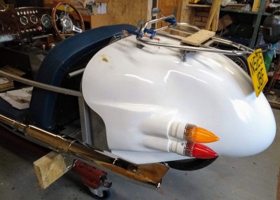

Post by peakrock » Mon Jul 13, 2020 9:17 am
Continuing the work on the rear end I've started assembling the new tail section. The rear lights are repro Cadillac, sourced from the US and surprisingly well made compared with some of the repro stuff you get. They are quite vulnerable so are lightly bolted to the tail so they can be replaced if necessary.
Next to the rear lights the silencer is playing its' part in setting the theme.. It's a Harley Softail Pan Tail modern replica, sourced from Germany. It's quite well made but came with no brackets or fixings of any kind. Once again, Al's engineering skills were requisitioned and he came up with a great pair of substantial brackets in stainless steel. I'm not sure the MSVA inspector will like these silencers as the fin edge is only lightly rounded but I can always put some standard Guzzi silencers on for the test.
Higher up, you can see the luggage rack has clamps etc on it, this is going to sit on my fabricated frame underneath and because of this and my one off tail section it needs "bespoke" feet and brackets, guess who is going to make the feet for me.....
Finally, the number plate mounting is one of those things I kept pushing out of my mind but eventually it had to be faced so I think I'll hang it off a short pair of arms from the luggage rack as then the tail shape isn't obscured too much..
