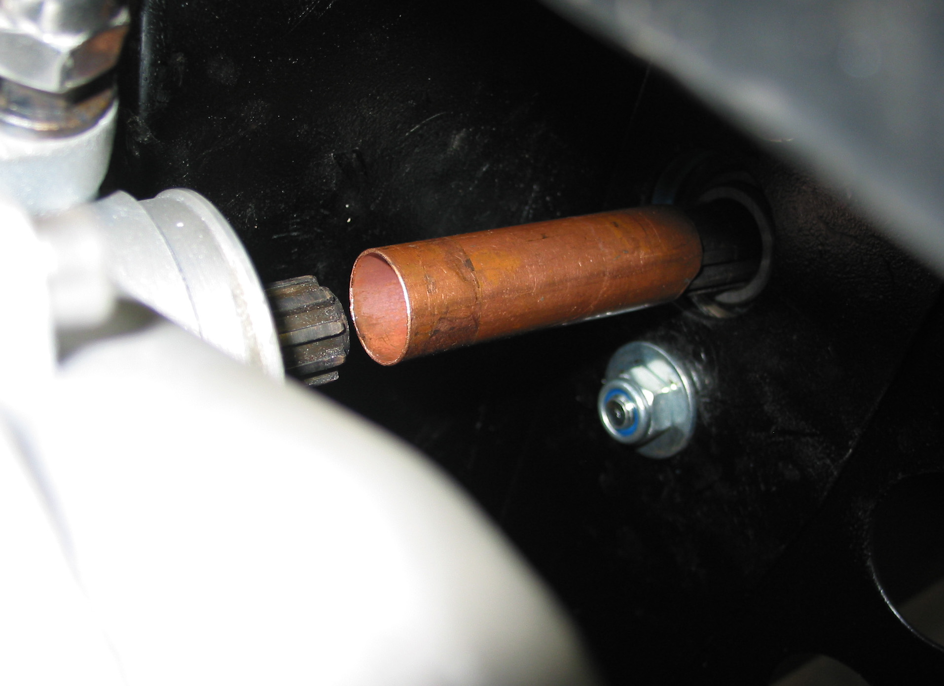

To get a better alignment of gearbox output shaft and the front propshaft, I used a piece of 22mm copper water pipe slipped onto the propshaft.
With the engine bolted in position (without the U/J), the propshaft support bearing can then be aligned to best position
Nip the bolts up, move engine forward out of the way so that the bolts can then be properly torqued up.
Finally fit the engine with the U/J.

No issues with this alignment on the type4, there is no extra bearing and the propshaft goes directly from the gearbox to the reversing box. The front u/j has a clamp that tightens onto the gearbox splines.
John.
