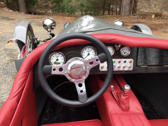

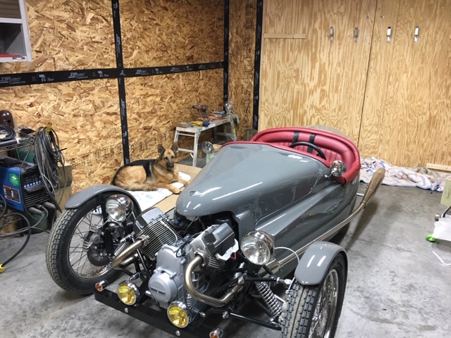

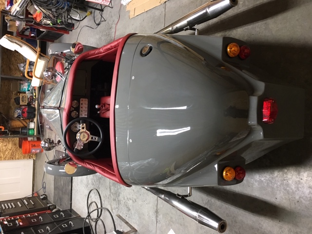

Just passed inspection yesterday. The state trooper was very professional and seen like a genuinely nice guy.
He looked over the Type 3 and went through his check list and gave it the thumbs up. When he was all done he said “ man that thing is really cool”. I offered to take him for a ride and he said he would love to if it was warm out.
Still have to wait for the state to issue a title and registration but the hard part is over.
