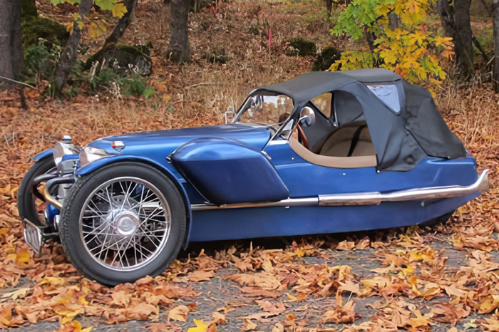

I was fortunate that my donor bike came with panniers, which I subsequently used as additional luggage space. Very little modification to the panniers or the car were required. I added an additinal exhaust pipe mount towards the front, then made a stainless mount for each pannier which is attattached to the exhaust pipes with about 1cm clearance from the pipes. An additional bolt goes through the side of the panniers and into the fiberglass body of the Triking to keep the pannier stable. Works quite well, and I think that they blend in with the Triking and supply a surprising amount of luggage space. They can both be attached/removed in 10 minutes or so.

My requirements were to carry my good wife’s requirements for a week away when required but be fully detachable. I fabricated a permanent bracket which fits under the floor. Two detachable foot plates then fit in to these brackets. The suitcase type pannier then clip to the foot plates. Suitcases can then be taken into hotel, b&b etc. Suitcase is triangular made from aluminium and covered with leather. The cutouts for exhaust are trimmed with engine bay heat shield and do not get hot due to forced airflow when travelling. Works for us.
