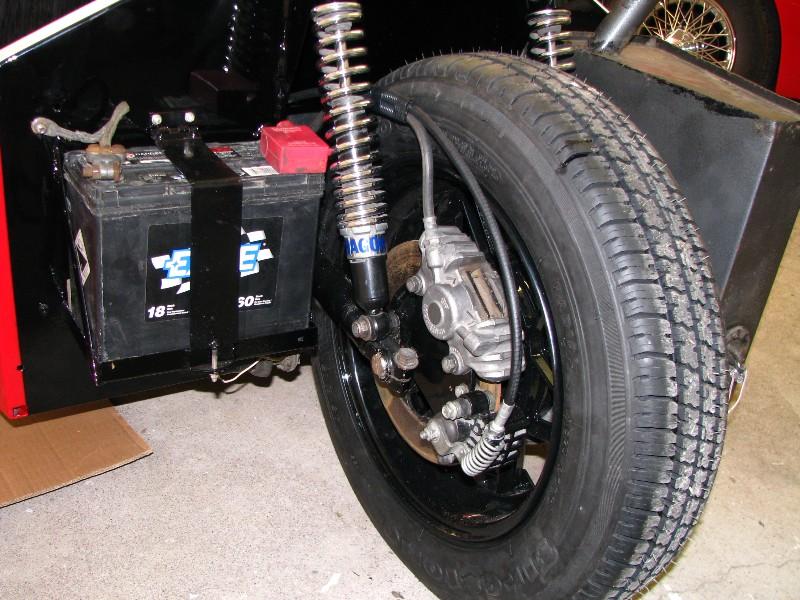

I have number 35 and it is fitted with the modified wheel and a car tyre. It seems to be wearing well but I will be looking very carefully at the drive train this winter given all the comments about the U/Js. I also need to adjust the handbrake.
