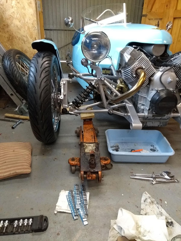

I'm on the hunt for new front tyres for the wide rim Type 4 wheels on my new Triking. The original ones I bought have a defect so I've borrowed a pair of wheels with Mitas tyres on which I quite like, lots of tread and they seem to work well. They're priced at £58 each on the web so tempting... I've also read the previous posts about tyres on the forum so I know there are mixed views about the Mitas. The Avon AM7 is an option as is the Metzeler Block K and the Heidenau too. Then there are the Michelin Pilots that Dick and Mark recommend...

I think I'm going for these tyres - they can be used tubed or tubeless as they have a butyl rubber lining apparently - obviously need tubes with the spoked wheels. A 130/70 x 18 will fit my rim - has anybody used this tyre at all ?

I bought a pair of 130/70 x 18 Michelin Road Classic from MyTires in the end and fitted them to the rims. These replace the Michelin Pilots. A bit of a job when they're cold and stiff but they went on ok. Here's a pic during the balancing process, I think I have enough wheel weights don't you... :lol:
Driving report will follow once they're worn in...
